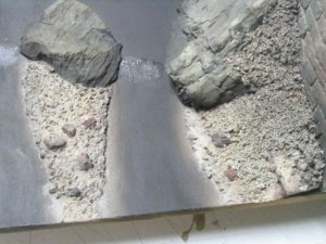

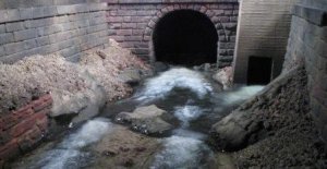

I used the Envirotex and gloss medium techiques and believe that the latter is the easiest to use and gave me the most flexiblilty to to work. IT really pays to build a mini test diorama to try out base painting, brush strokes and silicone for rapids.
I show how I made the water for my mill scene for the last Layout Party, which is not exactly what you are trying to do, but the techniques are the same, pretty much.
http://www.the-gauge.com/showthread.php?t=18380

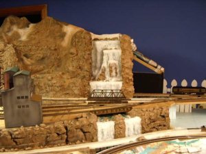

I used the easy plaster, paint and gloss medium method...the color can vary to suit your taste....this was my first try at modeling water and the method proved easy enough...Harold's stream is truly awesome though:thumb:
on the top waterfall I used WS water effects, spread it out on a non stick surface and raked it with a tooth pick for texture...on the lower one I used plain old latex caulk and did the same. I added a little paint for color and then cotton for foam effects. They still need greenery and such. I obviously still have a lot of work to do!sign1
