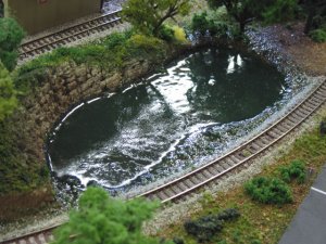

OK, so after all the prep work, I mixed up, tinted and poured some Magic Water. The resin did what it was suppose to leveling itself out, but I didn't realize it would soak up into all the scenery and foliage nearby!
So, I had to tear out all the plants and watch it soak all through the ground cover. I guess it will cover over with new groundcover, or worst-case, I can cut out the soaked stuff and re-lay it.
Any suggestions? How do the experts out there do it? Resin first, then groundcover?

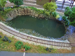

I also tried texturing it to look like pond ripples. More explaination and pictures of track changes at: Picasa Web Albums - Dan - N-scale model...

I would just add some ground cover over the areas that got soaked up. It will look more natural that way anyway.
my father and i had the same problems with Woodland Scenics Realistic water, all we did was use a putty knife around the area ripped it out, and re-laid it, but personally id say that was too much work, so just layer more stuff on top
Herc Driver
I'd add a light covering/dusting of ground cover. I think you got a great pond looking result there - I'd be happy to get it looking like that! One question...as sort of an idea...where do the ripples come from wind? or run-off? If it's wind, then I'd just cover the "wet" looking ground with more cover. But if you'd like to add a drainage pipe to make it more of a run-off pond, you could build it in the area you'd like to fix and add a point of interest to the pond while solving your problem area.

I have seen real water in layouts, and it does does add an element of realism. It also tends to wick up into the scenery -- at least in the layouts I've seen. Just like resin, it also forms this curved up edge where it meets the shoreline (something about capilary action). You can really see it in my pictures. It would seem the only way to stop that would be to add scenery on top of the resin to make a sharp, realistic shoreline.

On the plus side, the pond itself looks quite good. I think you have the water color just about perfect.
