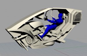

design4.jpg Scale set on 1:24. Model will be aprox. 15cm long, 5cm wide and 7cm high
Few things added. It takes some time to get proportion right (= how I like it :)). Modeling without blueprints is not the fastest way of doing it. Lot of experimenting and tweaking.

Dear friends, again I need your help to figure out how this thing works. Such things realy adds to the design. So my thinking so far is:
Stearing and forward motion: ??? Please HELP :) ( for stearing maybe little winglets and if this has jet engine then two rotational exhaust noozles behind? But this craft is called wasteland skiff and with jet engine it will set to fire the grass on wasteland :). And can not be used in the city traffic (only with wery long distances betwen wehicles to not get burned:)).
Hovering: Disc at the bottom is electromagnetic gravity device. It generates antigravity electromagnetic field by superconducting coil and rotating ring (based on Heim theory). Rotating part also acts as gyroscope to stabilize whole vehicle.
I am fooking forward to your ideas :)
13,498
9,549

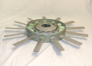

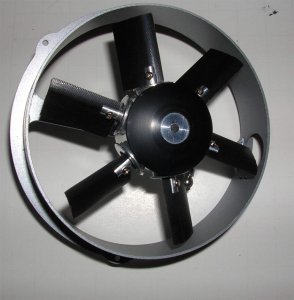

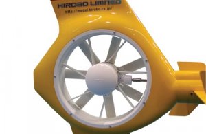

The disc will give rigidity in space., as in a real motorcycle, I would consider having one for lift, and for steering, and one at 90 degrees perpendicular, like a bow thruster on a ship), remembering, your input will actuate the disc 90 degrees after the input in the direction of travel, so any actuators have to reflect that. Inside those discs could be fan blades that act as cyclic and collective, allowing for steering, and leaning.
Fenestron rotors are works of art, the blades rotate in either direction, and making them cyclic would not be so far fetched. This machine would turn one a dime, have no hot exhaust, outer heavy rings and the speed of the glades would give rigidity in space ( i.e. a Gyroscope). One avenue to explore. The housing is left up to you, you just need to have an air input. That would be easy to design, the other directional one could be much smaller (even two, at each end) perpendicular, that one in the front or rear, though the front would make it steer quicker. Just remember, there is no lift it the glade tips reach supersonic, so factor the surface speed of the blades to determine the size of the lifting blade, which would be enclosed on top of bottom. If all three blade sets could rotate down, you would get incredible lift, and with the cyclic control, you would still get the control, at a much higher altitude. You imagination is your limit! :):)
aec-safety-tech-fenestron-img2.jpg Fenestron.jpg HeliArtist Fenestron 011.jpg
