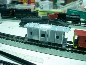

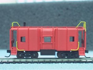

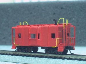

This has led to a caboose buying binge in the past few months to come up with parts to create the various B&O, C&O, and WM cabooses I wanted. I had come quite a selection of cabooses. Then I got lucky on an auction and got a resin kit of a B&O I-17 bay window caboose. The kit hasn't been offered in quite a while, at least 15 year or more from what I can find.

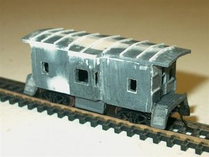

I know why the company that offered the kit is not around any more. It was definitely a "craftsman" kit. The kit required removing one side, shaping, and re-gluing just to get it square. Everything had flashing on it and on most of the parts, the top and bottom half of the mold didn't line up. After much filling and sanding to get the basic shape right, a lot of the original detail was lost. I started reapplying the details but the caboose started to look more and more like a Wagontop instead of an I-17. I sanded the details back off and rounded the roof edges to replicate the Wagontops. I cut the thinnest styrene I had into strips to recreate the ribs on the car. The windows took a little adjusting and I needed to make a new roof walk. It now looked much more like a wagontop than it ever did an I-17.
The next step was end rails which had to be scratch built. I had originally planned on using MT caboose rails but B&O had to be different and their ladders are on the opposite side of most cabooses, yet the brake wheel is still on the same side. There are no cabooses out there that replicate this properly.

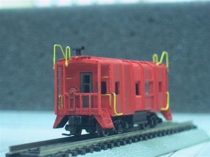

One last shot. I will post more once I get decals on it.
Above is one of the images I used for my prototype, care of: http://www.northeast.railfan.net

The first photo is the earliest I have. I didn't think about it until too late. When I start working on a project, I often forget to stop and take time to take pictures. I still have the kit handrail that I didn't even bother to try to use that I could take a picture of to show you what most of it looked like to begin with. I'll try to post later when I get back down to my office/workshop.

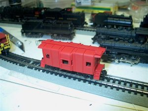

My decals arrived tuesday. They turned out better than I could have ever expected. Here is a shot of the caboose finally decaled and a shot of flat clear over it to help blend the decals. The decals were printed by a friend of mine from RC racing circles. I create custom vinyl decals and paint work for RC cars to help support my RC and now my train habit.
I'm still trying to decide if I want to do anything with the remaining windows. The two windows in the bays were very difficult to get right.
