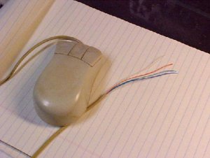

The mouse on my computer died this morning so I had to go buy a new one:(
I was about to toss the old one in the trash when I decided to strip off the wire just to see what was inside. "Lo and Behold":) four 8 foot strands of extremly fine insulated wire AND its as flexible as a wet noodle. This stuff would be ideal for hook ups inside a loco or for making working street/building lights. My wire gauge only goes to #32 and its smaller than that!!! :) suspect its probably about #34 or #36.
So don't throw away that "dead" mouse:D :D ... use it for a "transplant":D :D
Just thought I'd pass this on to my buddies on The Gauge:)
PS: If its a PS2 Mouse So much the better....they have 5 strands of wire in them.

Hi Shamus, Don't know about in the UK but we have yard sales and garage sales around here every Saturday. I see old computer mice (mouses mices???:D :D ) all the time for around 25 cents:) Think I'll go out tomorrow morning and get me a "stock"of them just for the wire:) :p Just for the fun of it I called the local hobby shop and asked if they had "flexwire"....They did....$3.99 a package which consists of a 3 foot piece.:eek: Looks like I may have "built a better mousetrap" already:D :D :D :D :D

Hi Gary, I haven't tried the "mouse wire" yet. I have wired some brass locos for sound and lights and can motors using #32 wire and haven't had any problems but these locos have less than .5amp draw under load. It would seem that unless the loco motor just went to dead short that there would not be a problem with the "mouse wire". Since most 12Vgow or 1.5V microlite bulbs and LEDS only draw 50 to 100 miliamps the "mouse wire" would be very suitable for lighting. I suspect that the "mouse wire" is probably best for lighting and sound and for motors with an extremly low current draw under load.
