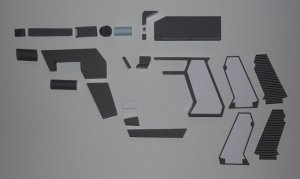

Hello again! :wave:

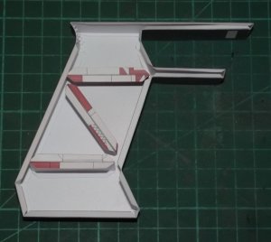

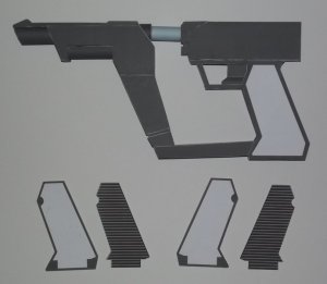

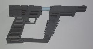

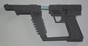

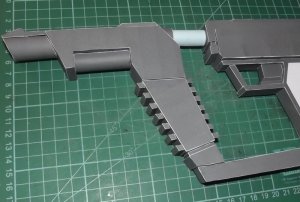

I have finally found some time to unfold the pattern and to begin test-building. I compared a 2D print of the CG gun with a well-known publicity shot of Jane Badler holding the original weapon to determine the size. According to this pic and the size of the resin model kit the blaster is approximately 12" long which will be the final size of the paper prop. Unfortunately the test blaster was printed 1 cm smaller, but that's not a big problem. You don't see it if you don't know it ;-) . One thing I was very uncertain of was the colour. It is very difficult to see the correct paint scheme on the photos I have and the colour seems to shift when the prop is lit differently. In addition, there were at least three different paint schemes ranging from all black to various shades of grey. I used a 72 % black for my build which makes it look like sturdy metal which is very nice (it really looks heavier than it is :twisted: ). However, I'll tone it down a bit for the final version. It seems that the original prop was molded in black and then drybrushed with the grey colours. Those of you who want to imitate that look may follow that example. I'll be making a white version with lines only, too, for those who want to print the parts on coloured paper or to recolour them according to your wishes.
announce1 And here is what you all have been waiting for: the first pics of the assembled prototype!

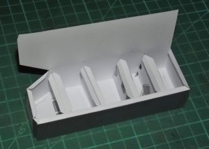

Pics 1 & 2 show the internal skeleton of two of the main parts. The next ones give you the parts for the body. It consists of a series of logical blocks which will support themselves exactly the way my other weapons are designed. However, due to the fact that there are only a few tubes and no funky foldings difficulty of assembly is comparably very easy and assembly is very fast. Everything looks good and fits like a glove.

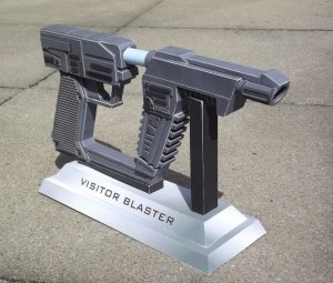

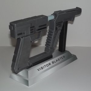

Visitor blaster ready
Hello fans!
Start with 10.000.
:twisted::twisted::twisted::twisted::twisted:
sign1sign1sign1
Just kidding!!!

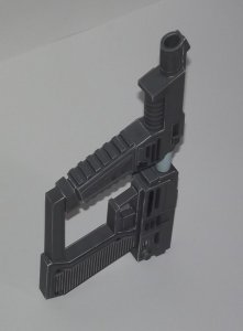

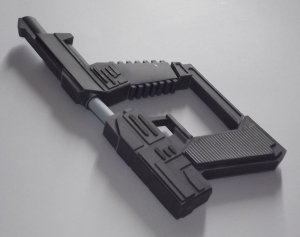

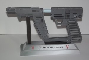

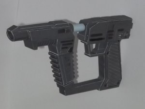

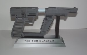

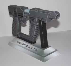

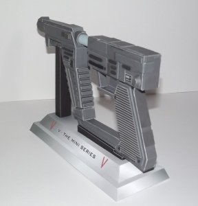

Short blaster countdown this time: Here it is, the Visitor blaster prototype....!
The edges still have to be painted. I assume that many of you may say that this one is true to the spot, however, when I compared the finished prototype and the images I had I noticed some discrepancies which made me revise some parts to improve the performance. The shape of the plating on the block above the handle was changed so that they are more accurate and I noticed that some parts should have laminated to some thicker cardboard to increase the relief structure. These little differences were very difficult to see on the pics I had. I wasn't sure if the dark areas were painted on the model or if they were shadows cast by the plates. New pics showing the weapon from a different angle revealed that they were shadows indeed which proved that the shape of the plates was wrong. Thank goodness these errors were noticed before the plans were released! Correcting these mistakes also gave me the opportunity to make the little on / off switch movable on the final model.
I'm a bit sorry for some of the pics because I had to use the flash which renders some of the detail invisible. You see more of the layered detail under natural light. I wanted to take some outdoor pictures but the weather wasn't good enough. I hope to be able to catch a better moment tomorrow and to show you some close-ups.

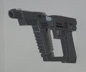

I'm now concentrating on the assembly instructions and will release the kit asap. Basically assembly is very easy, however, if you know my kits you might be expecting a special "Revell-Fan moment", which means a step which is fairly difficult or at least more difficult than the other steps. With the Colonial Blaster it was the caps, with the Raptor it was the tail booms, and with this one it is the "marriage" of the front and the rear end of the blaster. Take your time and work carefully.
What surprised me most was the fact that the model is extremely sturdy. You can shake it without breaking it, and even a tight grip doesn't crush the handle. Even though I highly recommend not to sit on it :mrgreen: .

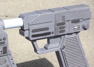

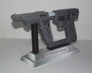

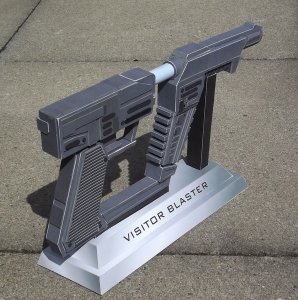

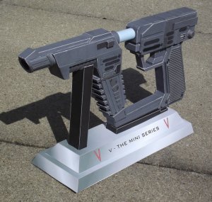

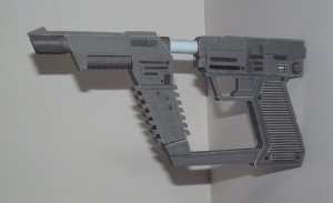

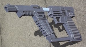

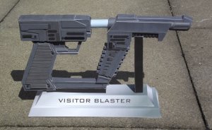

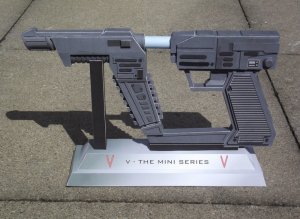

Weather was better today so that I was able to take some pics outside. Now you can see the laminations much better.
11,595
12,338

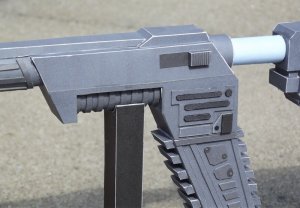

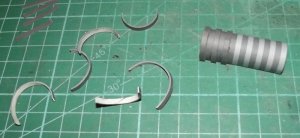

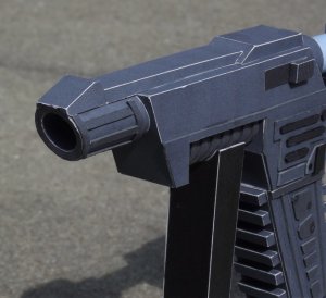

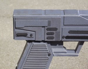

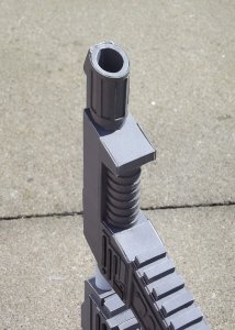

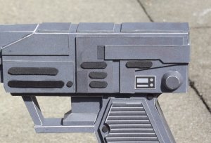

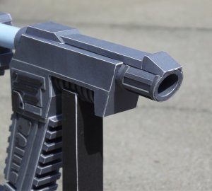

And the close-ups. The sides are not mirrored but slightly different. The left side is a bit more detailed. I glued some dark grey rectangles to the wrong platings to give the impression that these areas are recessed. The final kit which you all may enjoy soon will feature the correct shapes. Detailing the muzzle was very exciting because I didn't know if the cardboard stripes would wrinkle when they were bent around a pencil to make them round. I was lucky, they didn't.

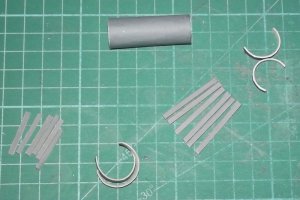

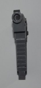

The half sphere on the barrel was also detailed with cardboard strips.
