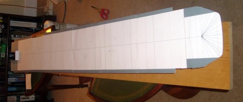

gantry deck
main purpose is to give a firm basis for the flying gantries above this one next comes the wall around the edges with added spacers enough to support the flight deck which comes after that. There will be a bit of a pause while I try and find some pics of the holes in the almost hidden top of the hanger and also exactly where to mount the lift to hide the interior. I shall do what John suggested and have a large helicopter on the lift for starters.
It's good to have a couple of friends who make helpful suggestions you lose sight of silly things like me trying to work out how to fit the gantries on A4 in portrait then John sends me a pic of the flight deck and says by the way I had to put it into Landscape, how dumb can you get !
Russell yea I sit here wondering how the hell to put the hull sides on let alone the flight deck.
Kevin retired mate too much time on my hands

More girders
Not interesting but necessary the formers are thin and the addition of a rightangle stiffener strengthens the joint and gives a better gluing area. I prefer this method to laying the card over the top of the formers.

Stern dock
Needed a lot of L sections to pull this lot straight but it seems to have worked it may not look much but it's given me a bit of confidence again if was starting again I would have built it as 5 seperate pieces and in thicker cardboard.
Sorry Jim but logic tells me that the next step after the after deck is glued down is the underwater sections otherwise I will make a right mess of John's flight deck turning it upside down.
I have got to paint the starboard side of the lower hull with rust as well.

Hull up to hanger deck
Last picture tonight. Waterline hull is finished as the Flight deck is treated as a very large deck house. Now sitting under the usual load of heavy books which will hopefully keep it free from warping
The second picture is for John it's stood against a standard door

That view against the door is VERY impressive! Once again, we see how huge this model actually is...HUGE!!
