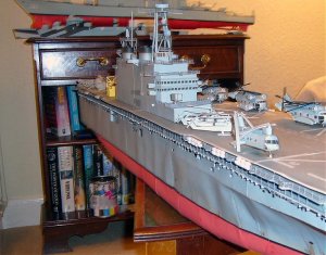

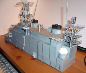

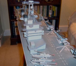

Bits and pieces
Ladders, rafts,radar arrays and still the end seems a long way off but I have nothing better to do and this way I don't have to cut formers out for a while longer.

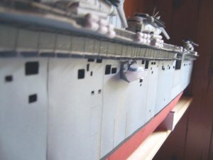

ladders and pipes
Thanks for the kind words Elb
Nightmare should have done this a while back

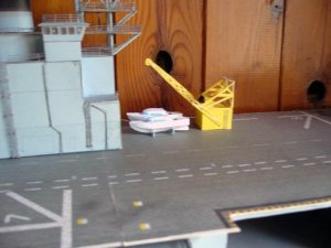

Boats
Boats and falls

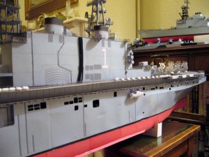

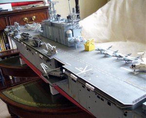

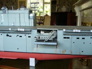

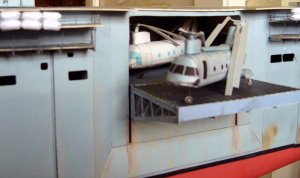

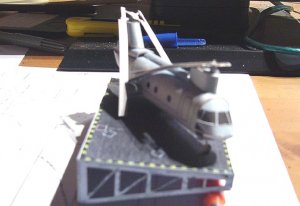

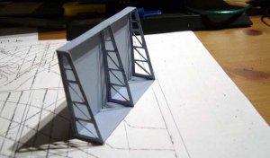

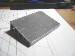

side lift
It's a side lift with a chopper on it to prove it fits !:mrgreen:
thanks Elb

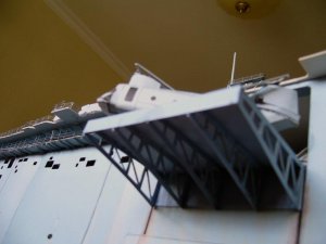

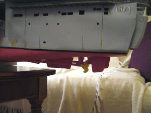

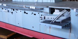

Side lift and bilge keels
These are the bits I dread knocking off when I have to move the model Have to go on sooner or later though.

Looks great Barry. Yes, these are fragile assemblies, and you can't wait late enough to put them on. One false move, and they're waste basket material.
It's hard to believe that chopper fits on that elevator, but it does... Just barely!

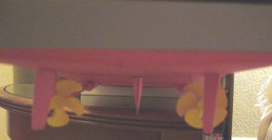

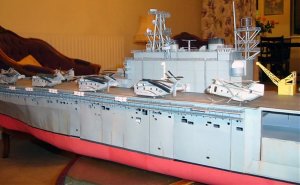

Propellors
Finally all the life rafts are in place and the props are on the shafts. Finishing the last bits is going to be the hard part. Biggest problem tomorrow is getting her back on the shelf in one piece.

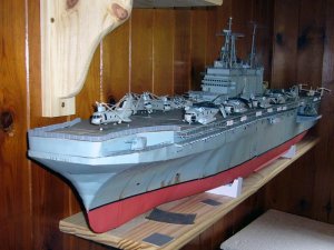

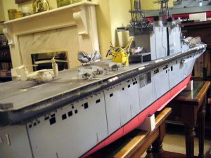

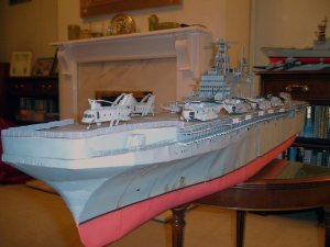

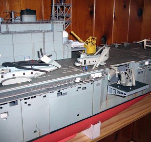

Back on the shelf
Ronson NOBI has a nice model of the Osprey.
Tarawa has one of the experimental ones sitting at the aft end.

Barry, I don't know what you're going to tackle next that is going to top the Tarawa. This is magnificent. You've got a very handsome model on your hands there.
I may have to use my powers of persuasion to convince you to design an old LSM (pacific cammo) :)
Look into the monitor Barry, your eyes are getting very heavy, you're very sleepy. :)

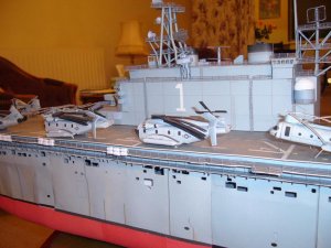

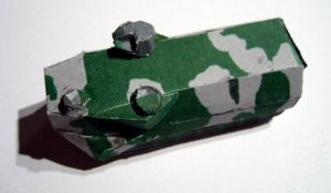

crew and marine vehicles
Not really finished lacks a lot of ladders, anchors and ancilliary vehicles LCAC etc
Jaffro this is the Mk1 crew and an AA7V (60mm long)
