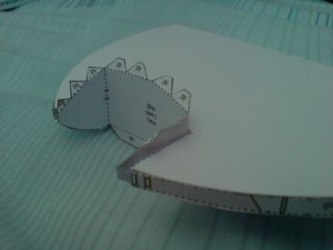

22point8
Aug 18, 2009
15
Do I want 22 to stick out from 20 or do I puff out 20 to make it fit 22? I've tried this part several times now and I hate printing off 4 pageswall1

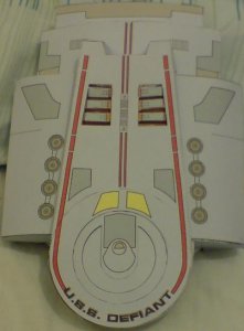

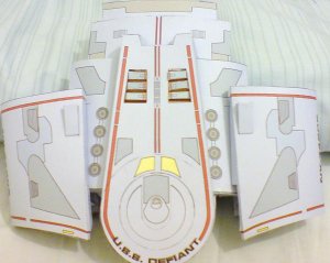

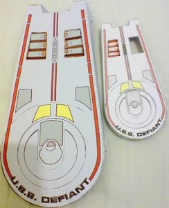

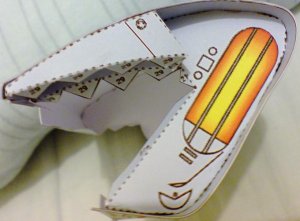

22point8
Aug 18, 2009
15
Don't feel bad. I am having some problems on this myself. I am relatively new to paper modeling, and I had to set this model aside and try something else. I hope to go back to this soon, and maybe we help each other with it.

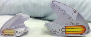

This is what I have so far, I've also been doing a baby defiant to use less paper while practicing, its actually not that difficult compared to the full size.

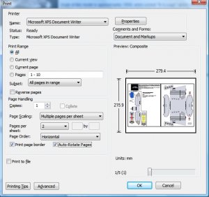

22point8
Aug 18, 2009
15
Thanks. Well I used Adobe Reader, then Print, Multiple Pages per Sheet, 2, Print Page Border, Auto Rotate, that makes the parts 25% or maybe less.
