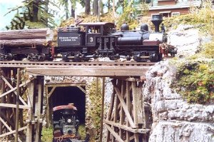

I like to see tunnels, whilst the real logging industry didn't have tunnels due to cost, my Badger Creek has two. One leaves the bottom level, dives into a tunnel and re-appears some 4" higher. Photo enclosed.

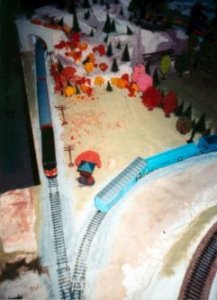

Just to let you know, I used this "Dual Tunnel" setup in order to hide the Helix that allows the "mine train" to change levels. The train enters from the right side (under the window) and then comes back into view at Kelly's Kaverns portal. Then it goes back into the mountain, finally exiting toward the left. It works Great!!! Also Andy is Absolutly Right!! Make sure you can get under the tunnel, I left that part out, only because I have boxes stored under the platform, and I am regretting it!!!! Let us know what ideas you come up with! :)
