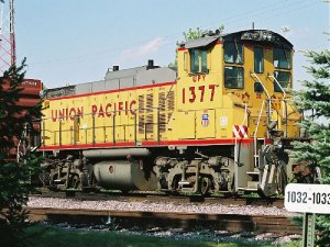

Hard to believe but this unit is or nearing 30 years old.:eek:Still earning its keep in Sparks NV. :cool:

Greg, we had a discussion at our model railroad club meeting last week about why EMD used the low radiator grille on the GP15's. I know the tunnel motor was designed that way because the SP had problems with units overheating and shutting down in long tunnels and snow sheds, but I think the GP15 was designed more for branchline service. Do branch lines have long tunnels that would require those low radiator grilles, or was there another reason why EMD made only a couple of locomotive types with the "tunnel motor" grilles?
Russ Bellinis
Feb 13, 2003
4,501
Lakewood, Ca.
I've wondered that myself. The MP-15 also has tunnel-motor style grills, perhaps EMD was testing performance with that style of air-intake to see if it would turn out to be more successful as a method of air intake.
Technically it is not the air intake. The air intake is the rectangular filters located at the top of the long hood immediately behind the cab. Those grilles are intakes for the cooling air to the radiators which are located at the top of the long hood at the very back end. The radiator fan is mounted horizontally under the radiator and blows up through the radiator coils.
