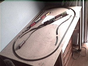

Hey Luis - I just went to your web site and couldn't get off your home page. I wanted to check out your track plan, because it looks like in your photo you may have a couple of "Ess" curves that could give you trouble (the loose piece next to the track on the left).

sorry luis just check out our site and your track plan you have to watch out for them s turns you will get alot of derails there and you dont have a reverse loop from your track plan:D rich
