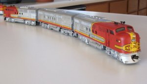

I have always thought the Santa Fe FTs were an attractive group which stand out against the later and more popular F7s. Here is a set of FTs I built many years ago painting and detailing old Bachman shells and a Cary B unit shell. The running gear is all Athearn; only the first two units are powered.
I am currently in the process of detailing newer Bachman F7s in an A-B-B-A configuration. Today's Bachman engines run so much better and use so much less current that I am finding success with all units powered.

Mike,
I bought these locos years ago when the Bachman running gear was rather funky. I had to replace them with Athearns. The shell straddled the frame okay, but didn't lock in place, so I kept them in place with a few drops of Walther's GOO which is a semi-permanent rubber-like adhesive. It allows me to easily remove the shell for servicing now and then.
That was a long time ago. I think today's Bachman running gear is excellent and I would not trade it for Athearn's.
