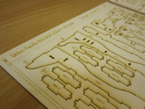

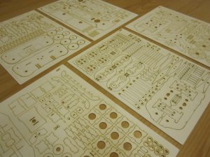

Today I've received 5 pages of laser cut parts. After checked all dimension , found no size error. I'll start to build frame bed this weekend. I got a recommend from the laser shop to reduce lines' nodes. There were too much nodes. It makes the line be like a dot line and extends the cutting time.

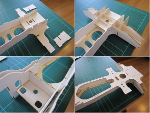

Hello there

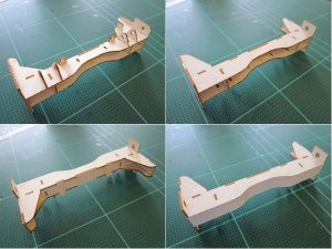

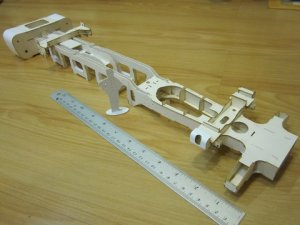

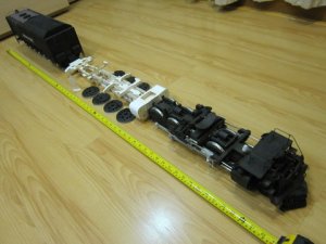

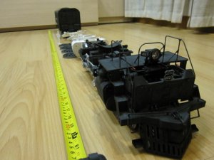

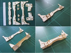

Start to build the back engine's frame bed. Long frame pieces were cut by hand. Others are laser cut. Laser cut machine was well calibrated. All parts are sharp and exactly in precision.
The building sequence is engine main cylinders , inner frame , outer frame and back frame. There are more parts than the front engine's. Some parts cannot be added later if assembly in wrong sequence.

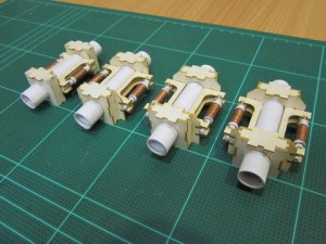

Hello all
Thanks for following my work and all your kind words.
This project takes longer time than my expectation. But I never felt that it was too far to the goal. Because I've never been alone on this way. Thank you Bob for sticking with me.

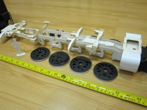

Today I spent whole day for wheel box. All parts are from the front engine. The laser cut parts could save my cutting time for cardboard parts. But rolling the shafts for springs and wheels ate so much time.

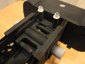

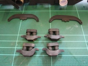

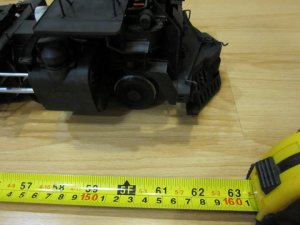

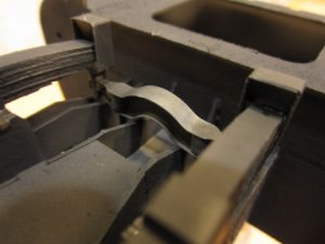

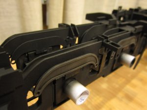

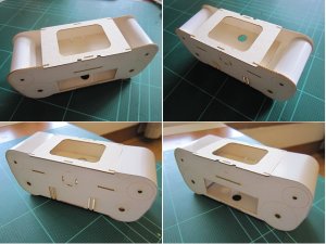

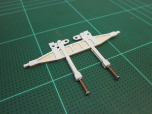

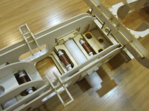

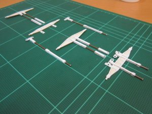

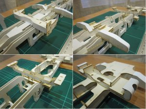

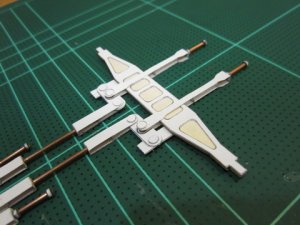

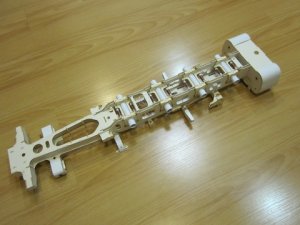

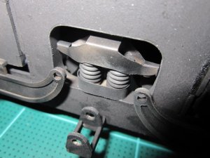

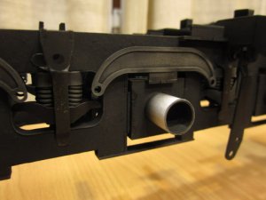

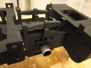

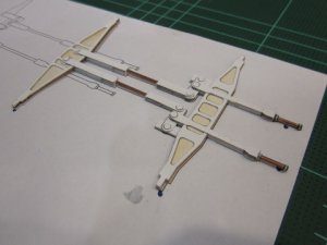

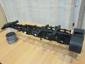

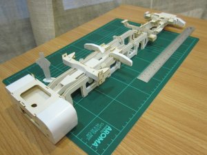

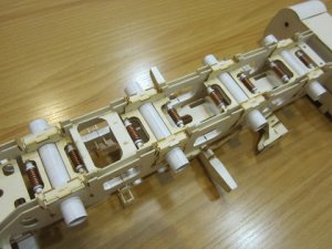

I spent 3 weeks for air brushing frame bed and starting the suspension units. There are so much parts to assembly on the suspension. I can't finish within today.

In my younger days, I worked in a leaf spring shop and used to make leaf springs for tri-axle dump trucks and just about anything that had leaf springs. We were one of 2 shops located in Connecticut. I was on the west end of the state so it would make anyone interested easy to find. It took a 50 lb. hammer and a twin forked anvil, lots of heat and you wore asbestos gloves. As I progressed, I ended up in the aerospace industry working on the Hubble Telescope and eventually, at Sikorsky Aircraft. I offer this up only to tell you with some certainty, you model looks like the real thing. Not close, but exactly like it. The metallic wheels are familiar as I lived 10 feet from a train station, Branchville , Connecticut, and saw trains every day. The way the shiny part connects with the black part of the wheels is exactly right. It is actually amazing. The whole model is, so far, and I have been following it since you started, amazing!

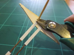

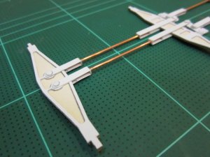

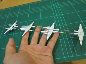

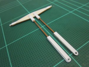

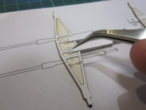

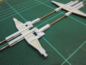

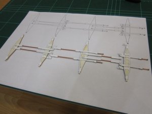

Hello there

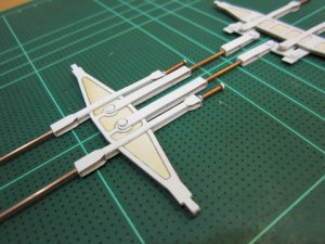

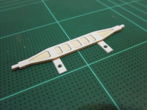

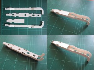

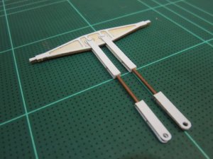

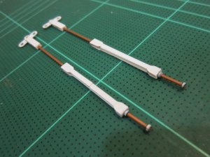

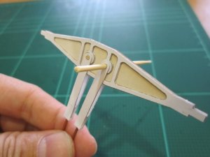

Slow crawling project. I've started brake links a few weeks ago. Today I combine all parts together. By the experience of the Front Engine's brake link , I improved my assembly method by do all on a template. This method is better for both assembly and precision.
