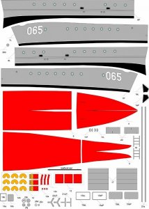

You can also look at doing the sections lengthwise down each side of the ship as shown in my attachment (from a model I'm currently working on).
This can reduce the number of visible seams on the hull. Even if you have to split the pieces, so each side of the bottom hull is a separate piece, you can split them at the keel so that seam is mostly hidden from view anyway.
