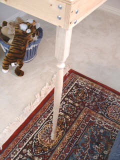

Mike,
If you have nice hardwood floors it must be a nice room. Maybe you could use nice "furniture-style" legs on your layout.
(These are made from stair balusters and have a plastic "coaster" at the bottom.)
I don't know your plan but you might consider "shelves" mounted on the wall.

Mike,
I picked up an area rug like in Jim's photo at a flea market, still in good shape, for $5.00 it was 6' x 9' you would need two. Now that's well within the budget and if you ruin it, so what. Must save those hardwood floors.
