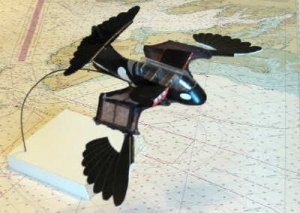

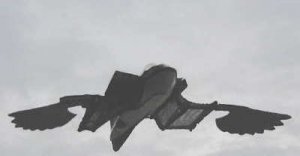

The wing design is starting to come together. I'm using nylon trouser socks as the wing skin. The skin is a pain in the petootee to sew. Since the fabric is so stretchy I can't do it on my sewing machine and must do it all by hand. I have to use lots of pins to keep the fabric from curling and then the pins fall out. On the next build I will pin the fabric to paper to keep everything in place.
On this version I roughed in the wing ends so that I could focus on the skin. In the next version the wing ends will fan closed. It's nice to see this starting to come to a finish.
I do need to work out the hydrofoil landing gear, but that shouldn't be hard.
I tried posting these pictures into the gallery but I haven't figured out the new system yet.
Lizzie

You can use super glue on the panty hose material. Either to hold it in place on the corners while you sew or as a more permanent bonding agent w/o sewing. another option would be to "sandwhich" the material between two pieces of paper, the main body part you are adhering it to and another piece ontop of the material, which might be scales, feathers or just paper of the same color as the part below it. Then you can trim the excess material after the bond sets and the glued joint will be covered with paper ontop and bottom.
I know this appears vague and would really help if I could illustrate it here but, I havent figured out the pics here either yet lol. But, I hope it helps or starts you thinking about easier ways that you may not have considered.
have a good day,
Greg aka GW

"You can use super glue on the panty hose material."
GW, Just how would you know that???? :) LOL
Any way Lizzie, you might want to try some fabric adhisive. The wife uses it to hold some of her loose fabric on her tear-away stabilizer when she hoops for doing machine embrodery.
Just a thought.

The difficulty is that the stuff needs to stretch and most things put on this will either come off when the fabric stetches or keep it from stetching. Superglue is brittle.
I've considered laminiating the fabric to a latex membrain (I'm not telling you where I'd get the latex but I'd wash off the lubricant) with Barge cement or Shoe Goo. The would make the fabric more windproof but wouldn't help with the attachement problem. I'd have a problem with people identifying or asking about the source of the latex.
Hm shoe goo might be worth a try. And then there is silicon caulk. I don't think I can get around the sewing.
It's good to toss around ideas.

Dave,
Good idea. I could get some water soluble sizeing to hold it stable while I sew on the machine. Maybe ordinary laundry starch would work. Then I could wash the sizing out. I tried stablizing the fabric with paper but pulling the paper off the stitching was as tedious as hand sewing.
Hm then I do the final sewing by hand and cover most of that messy stitching with silicon and some cardstock. It will have one seam visible on the leading edge but if it's machine done it will look better. I don't want the fabric to stretch much on the leading edge so the seam works well there.
You guys rock with ideas.
Lizzie
