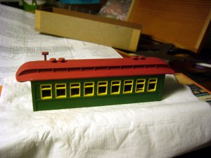

In that spirit, and in the spirit of finishing a few half-baked kits, I pulled out the Sierra Coach I started a few years back. The body has an initial coat of paint and the underbody detailing is completed and likewise has its coat of black applied.
What's left is the interior (great little Walthers add-on), the end rails, decals and weathering.

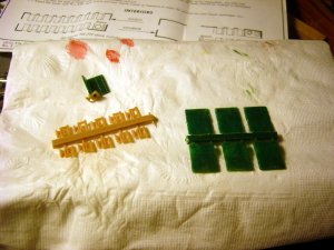

The tricky one is going to be the interior. A floor plan is provided but is not to scale. I figured I could photoshop it and scale it up to size so that's what I did, then printed a new one. Fine.
Now the hitch - the little seats provided are WAY too wide. I'm debating on whether to narrow the seats on both sides of the aisle, or chop one side in half to make a double row down one side and single seats down the other. Any thoughts?

I'd narrow the seats on both sides... But that depends on how the seats are contructed as to how feasible that is.

Kevin - The seats are a flat plastic seat and back piece that is bent to shape, then an armrest/side/leg piece is glued on each side. I'm leaning that way too, narrowing both sides.

I would only cut one side of the seats (the side that faces the coach walls, or perhaps leave the armrest off of that side. If you go about slicing the seats themselves, perhaps a razor saw and a miter box could make short work of it while watching a ball game.

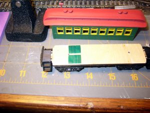

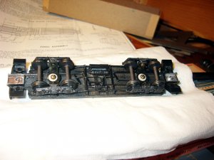

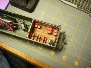

Dokey Okey. Hopefully you can see the outstanding underbody work - not that my workmanship is all that, but speaking strictly about what the kit provides. It was fun building that brake rigging, although I don't think I'd do that for all my rolling stock. I'll certainly install it on the combine, however, I want to finish this one first before starting that one...although, it would be advantageous for lettering, weathering, etc. both at the same time...hmmm...
Note how close the seats are even just laid out unbent on the car floor. That's without the seat sides/armrests attached! Plus, I have to leave a 1/32 or so gap next to the car sides because of the strips inside the body that prevent the floor from going any higher in the car.
Excellent idea! A single strip of styrene or wood running the length of the car beneath the seats could suffice to support the seat itself along the walls.
I've got a Chopper II that has never been used...that may work for narrowing the seats. I'd just set the width stop to get them the same every time. Hmmm...

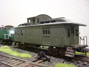

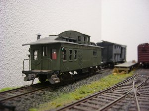

Here's a little combine I kitbashed a few years ago. The first pic shows the dockside switcher (an MDC Critter) shoving her down the rails.
Next is the other end after she has been spotted down near the section house and rail gang materials storage. Looks like she may be coupled on to a work extra in the near future. Those markers will most likely have to be moved to the other end.
Lastly is a shot of the detailed interior. I can't remember where I found the interior details, but the walls are business cards colored with felt pens. Other items are painted with Delta acrylics. That new coal hod needs filling.
Maggie started life as an MDC Combine (50' I think), one of the older kits, not the newer RTR jobs. The cupola is scratchbuilt, as are the running boards. She has been fitted for drover's service with additional grab irons on the sides and full width coupler cut bars. Not based on a prototype, but the VGN is a stockholder/parent company for the Ocali Creek Railway so the shop crews retained the VGN lettering when the refit was done.
