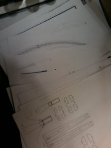

I've been seeing at this beauty since my girlfriend saw it (she's a Startrek fan. Well, not so much a Kirk fan, she thinks he's kind a punk. Anyway..) and now that i have time (and taken courage, have to say it) i'll go with this enterprise:).
I hace many doubts, but one in particular with the paper. I would like you people to give me some advice about it.. i have matte inkjet papper, 120 gr and 150 gr. Which one will be better in your opinions?
I'll wait for your advices. Well, i'll do, in the other hand my printer is a little anxoius, mouth open waiting for the paper;)
Thanks in advance.

My advice: print it up in the lighter paper first, determine which parts are structural parts by seeing which ones will be bearing the most weight (the neck and nacelle pylons are the obvious areas), then print those parts in heavier paper. Any structural members (blank parts that will be inside the model and serve as strengtheners) should be laminated to heavier cardboard.

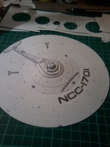

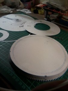

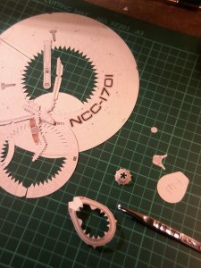

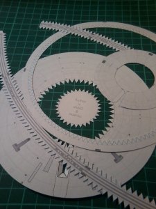

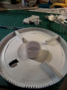

So, decide to build it. Printed all the large pieces on 150gr matte and the mid/small on 120gr matte. But some mid on 150 so... it was weird. An experiment, almost a lack of rispect. By the time i printed i was a little overwelmed about the complexity of the design.
Here you can see structural pieces laminated very hard, unnecesarily hard. about 0.5mm cardboard.

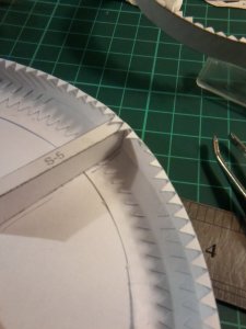

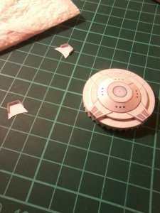

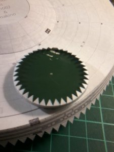

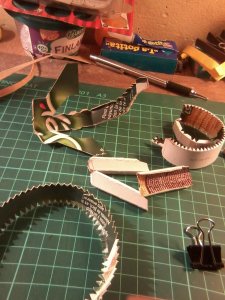

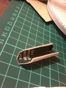

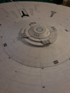

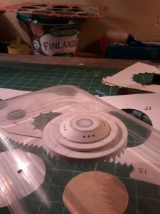

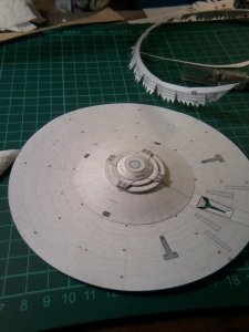

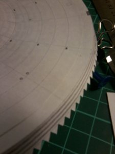

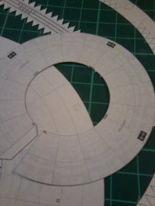

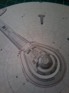

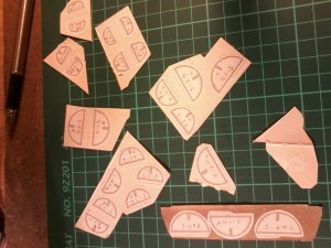

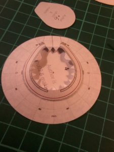

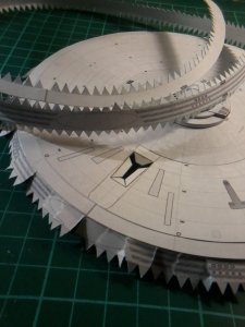

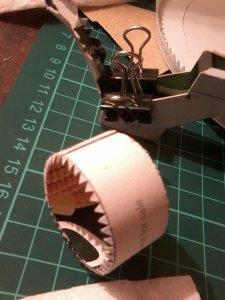

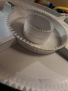

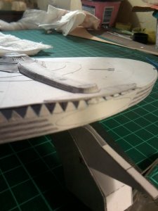

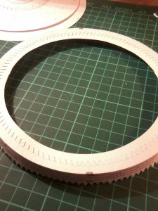

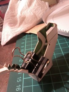

and then... the first stumble. I don't remember now why, but i decided to reprint part of the big plate (don't hit me hard for the ship part names...) because didn't go as planned.
I think i builded the ring a bit closed than it should go, almost indistinguishable until finishing the whole plate. Don't know why but instead of print everything again, i removed the ring. The surgery was not bad, in fact it resulted ok, but offcourse the tabs of the former ring were there, so that section looked deep, like if it was laminated. Latter i printed another whole plate.
20150821_230520.jpg20150821_235750.jpg20150824_185123.jpg20150824_185138.jpg20150824_190712.jpg20150824_202624.jpg
12,493
9,857
Thank you Rhaven! As you can see, it was kind of afternoon novel. I Have to resize pictures to post but it's late, so tomorrow you'll see the chapter 2 of this novel.
One of the things that you can do, is cut the glue tabs off, and use strips of paper in place of the tabs. You will get a more "finished" look.
