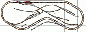

This is a door-sized (30x80) plan that has a twivce around and double track (throw the red turnouts to make the switch) wouldn't be hard to extend the siding along the bottom to connect with your other track.

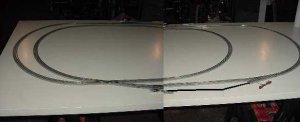

Thanks for the comments, guys. :wave: I threw some track together the other day, and this is what I came up with. It's just quick and dirty and by no means a final plan. As it is, there is room to add spurs and to adjust the size of the loops.
I am also considering double track instead of the twice-around. My main reservations about double track are that it's harder to scenic around than single track (although the twice around will likely have the same problem!), and that it requires more turnouts (which are not cheap with Unitrack).
Brakie, did you say that at one time you built a double track N-scale layout? If so, do you have any pictures?
