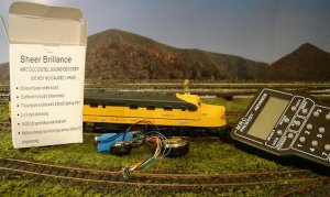

OK GUYS, i am NOT an expert on sound decoders, HOWEVER, i do have OVER 50 engines i have bought with sound, or have put sound in(yes sound IS IN my ENTIRE fleet). OK, here are MY views on the sound decoders i have. QSI=BAR NONE, the BEST!, Loksound=close second, Digitrax=ranks third with me, MRC Brillance=hits #4 in my book, and last, and most certainly the least i like is MRC's cheap AD370;). SORRY guys, i DO NOT have Tsunami:(, why?, good question, don't have a good answer other then i waited for it to come out forever, and in that time i took a liking to Loksound. the ONLY thing i DO NOT like about Loksound is...i think the horn/whistle is to quiet. seems funny how ALL the other sounds Loksound has are quite loud enough, but the horn/whistle is another story. PLEASE don't tell me to adjust the CV's, cripes, i AM the CV king:D, i adjust the CV's in ALL my decoders:thumb:, thats just the ONLY drawback i think Loksound has. RUNNING wise, QSI and Loksound are the icing on the cake!:thumb: :D **BOTTOM LINE, of the top 4 i have rated, ALL of them have there good points and bad points. EXAMPLE: the horn may sound better to you on QSI, but the bells might sound better on Loksound, etc, etc. MY best advice is to listen to a friends, or at the hobby shop to see what one YOU prefer;):D. **AGAIN, THESE ARE ONLY MY VIEWS ON WHAT I HAVE.hamr I TRULY HOPE this will HELP some of you in some way, THANK YOU, -UP SD40-2 View attachment 27204 **FINAL NOTE: i started my whole sound venture with a Soundtraxx LC sound decoder, i have since replaced it with Loksound.
