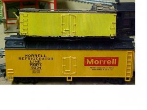

Hi Bill, I found a use for those old AHM reefers.....Since the door height and the siding spacing is correct I cut them down into HOn3 reefers. Here's a pic of one in the works:)

Thanks Gary, Actually I should have said that I cut down the sides to make the NG reefers....The floor is just a piece of styrene siding and the rest is Grandt Line Parts:D
Now that Precision Scale has those beautiful HON3 reefer kits I kinda lost interest in building these out of the AHM cars:eek:

Excellent!! My road uses the wood, double door boxcars...remove the deep side sills, add a fishbelly underframe, file off the corrugations on the ends, add end siding, roofwalks, vertical brake wheels,grabs and door details. Great kitbashing fodder! Bill
