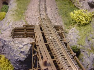

You are right there Robin. Some of us sit and even cut out the tie web spacing to slide the ties closer together. This curved one on my layout was very time consuming. (Wished I had taken the time to fill in the tie nail holes, still not too late I guess) For my guard rails, I cut pieces of track and preform it. Using a soldering iron, I CAREFULLY go alond and heat the guard rail. As it heats, I am applying a little pressure to push the rail slightly down and out. This will set the rail into the plastic tie and into the molded spikes. Takes a little practice, the key is to slide the soldering iron along when you first see the rail start to move. I found that the spacing of the rail, if just attached alongside the spikes, was too large and sometimes a bit too high. Luckily my trestle is right in front, great rerailer, for I use it to set up my rolling stock.

Bill P - That's a great looking trestle. Just curious - did you consider removing a part of the guard rail (sorta like the crude sketch below) so that it wouldn't be too high and wide and then gluing the guard rails down rather than using the "melt in" method you described?

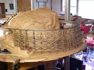

Mike, I usually don't get "riled up":mad: at anything I read on these boards but I'm afraid you have hit a sore spot with me.
Modeling anything is nothing but a series of "compromises". Just how well one can do so is limited by one's ability and talent. The guy with the HO 4x8 circle of track and some plastic buildings and his over and under trestle is just as proud of his work as the "pro" who has created a scale "empire".
Unfortunately I see nothing but discouragement rather than aspiration in your comment. In support of what I've said I'm attaching a photo of a curved trestle I built last year. Its every thing you say it should not be...but By Golly I built it and I'm proud of it.

I'm dismayed at your choice of words although I do see what you were driving at. It would have been received with much enthusiasm had you included an excellent photo like Bill's or a detailed sketch to enlighten the likes of me who has never seen a trestle or drawings of one.
Please don't take my post as a flame, but rather as a strong suggestion to submit items which will encourage others. Few if any of us are civil engineers and we model items within our skill range and willingness to compromise on detail. After all, it is the overall effect of what we model which pleases us.
Vic, I need a trestle like yours, any chance of sending one in a "flat pack"? :D . You did a great job on that one, thanks for sharing.
Bill, I'm saving your photo to hard drive for future reference, thanks for such a clear photo.

I agree with you Dave Flinn so all I will say is I really like the way you did the guard rails Bill. Just excellent.
Vic, your trestle looks just like the old ones that existed around loop creek near Rogers Pass on the CP line. They all disapeared when CP built the Connaught tunnel .

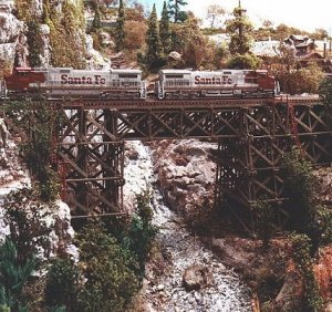

Well, I must admit that all my trestles were built from photo's of originals, and only from the side, never ever seen the top of a prototype. Anyway, here's a trestle I made years ago for my N-scale, I know that these monsters on it wouldn't have been using this kind of bridge, but I liked them.

thanks everybody for a great thread. I have enjoyed very much reading everybody's comments irrespective of their bias, and certainly enjoyed seeing the work of Bill & Vic and Shamus yet again.

And Shamus, is there any thread ever posted that can't be enhanced by one of your pictures, and the loyal adulation that follows ? REALLY NICE TRESTLE, SHAMUS! There you go, just a quickie compliment fix, as some of your regular disciples were a bit late with the kudos this time.
