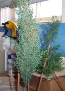

I ran into this stuff the other day, its called Marsh Pingrass and it grown in low ground marsh area's.
I gave it a quick spray paint just to see if it had potential.
As is it looks like it would almost do as a Lombardy Polar tree. this is untrimmed and sprayed only so dressed up with some foam and trimmed some i believe it has potential.
It certainly would make a good forest filler behind your nicer front line trees i believe.
What do you think??

That's not a bad specimen at all, it should look good on your layout. I'm still looking for any pictures that I might have of Spirea, but not having any luck. I would imagine that there would be some on the 'net though.
What do you think??
I'd watch out how you walk around outside with that after it's been painted. Someone might mistake it for marijuana:D .
I think it looks great, but I'd like to see how it looks in a scale setting.
