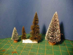

Here are a few of those dollar store trees you can get for Christmas town scenes. If you'd like to change them, here's how I did it:
Hack away at them with some scissors to remove some of the branches, and give them a less "groomed" look, and cut away all the "snow". Paint with dollar store craft paint. Bend to slightly irregular shape. I tried adding ground foam to one of them, but was not pleased with the result.

Good source for the smaller trees dash. Mine were 3/$1. (All prices $CAN ;)).
The bigger of the two trees is about 5 inches tall (2/$1) and the biggest tree (not pictured - 1/$1) is about 7 inches high.

Andrew, that works for me! :)
Though, the 'before' snow covered ones don't look bad. I wonder if you could "nature" them up to look like your 'after' trees for a neat winter scene? If they are cheap, you can have two sets of trees and swap them out during the year. :D

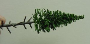

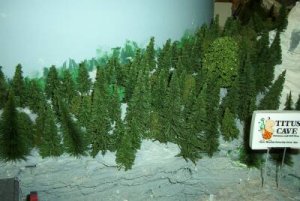

Hi Mason Jar,

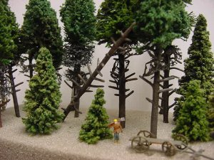

Hope you don't mind me adding to your cost effective method of adding a pine tree forest to your layout. I tried everything to come up with a realistic look for my new N Trak module and finally came up with combining Woodland scenic pines and the Heki.

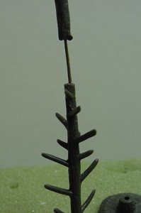

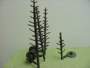

The Woodland scenic trees make great trunks only. The heavy globs of foliage they provide is the pits. I take and cut one off at random length to provide a little flat.

Tried drilling the hole for the Heki tree but could not hold them to drill the hole, came up with an alternate method. Drilled out a tip to my sodering iron and inserted a pin. When the pin is hot it goes into the plastic Woodland Scenic stump real easy.

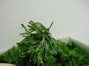

The Heki trees 100 for $16 - $18.00 depending on LHS. (same trees less the mail order kind at +20% and shipping costs) Using a needle nose pair of pliers, open the wire twist and remove enough of the bristles to expose a wire end.

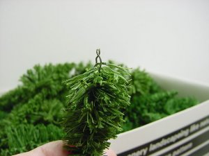

Bill Pontin
Oct 14, 2001
708
83
Milford, CT
close the wire twist and bend or cut off one point, straighten the other and instert it into the melted hole of the Woodland Scenic stump

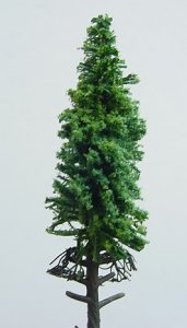

Bill Pontin
Oct 14, 2001
708
83
Milford, CT
Using Woodland Scenics ground foam, several shades of green grass, (The finer stuff for "N" scale, probably the heavier stuff for the other scale). Spray up the bristles with an adhesive spray and add a very dark green. Spray down the tree brsitles with the adhesive and add a lighter green foam. Clean up the trunk and paint. I also add some old roofing vent material I have to simulate the dead twigs below the green.
