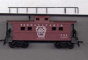

I model in HO and have been seriously considering using Athearn diesel hand rails to create a train phone antenna. You could move pairs of the stanchions (sp?) together to make those V shaped supports. I've included an unsophisticated pic here made on my scanner to at least give an impression of how it might fit. I haven't moved the stanchions where they should be or tanything. Are O scale handrials like this available?
Neat project!

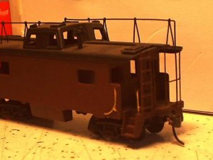

I built the one on this kitbashed caboose with steel wire bent on a home made jig.
If I were going to build one in O scale I'd use brass strap formed in a jig for the supports and solder in the cross braces to form the "A" shaped supports While in the jig.
See the thread "Pantographs" to see how to make and use jigs.
