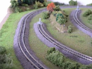

As a user of the Bachmann EZ track, I wholeheartedly agree with all of the above posts (both pro and con towards the pre-fab track). I started using the EZ track because I originally had no intention of keeping a layout up and running, only putting it together for the kids once in a while. But our desires changed and the layout has stayed up for over a year now. That being said, I wanted to try as best I could to replicate some of the quality work I saw pictured on this web site on my layout. I've found that when dealing with the track, it is a bit more challanging to get the EZ track to look like "traditional" track. It is slightly harder to ballast and slightly "noisier" than cork roadbed/track. It is more expensive, harder to interchange between brands (you can use an adaptor from LifeLike to attach Bachmann to LifeLike for more track options), and limited in what type of turnouts you can have, which again - limits your track plan. You can still cut and modify the pieces just like regular track. But right now, you don't have all the makers and choices of track and turnouts to create elaborate or more complex layouts. So really, the choice is yours and may I suggest, based on what you'd like the finished layout to operate and look like. If you want to be able to utilize almost any track planning book, software, supplies, and various makers - go with traditional track. If you like the "look" and ease of the "plastic tracks" then make the investment in whatever brand you like and a good trackplanning software package that has your plastic track as an add-on. You can still get the "look" of traditional track (see picture below) but it takes some effort, and you can still create some pretty elaborate and complex layouts with plastic tracks. Good luck deciding which way to go. As for me, I'm glad I used the EZ track for this first layout attempt, but when I'm ready to completely redo/enlarge/improve, my next will be flex track...but here's a picture of the ballasting job I was able to do on the Bachmann EZ track before it was cleaned up prior to (scheduled to be done) track weathering. Also, you can see more pictures of my layout progress on this forum. Mine is certainly not the "best" example of EZ track usage, but might give you some ideas of what could be done or improved upon. Mine is still very much a "work in progress" and I keep learning from others right here on this forum.
As a side note...I sincerely appreciate the other members/posters here on the-gauge for not making disparaging comments about the use of EZ track. I have read other comments on other model rr websites that have been quite negative about the use of any type of plastic track, saying in essence, that those who use it should not post to or be included on any model rr forum, or be considered a model train enthusiast. I must applaud the politeness found on this web board and have appreciated the kind and instructive comments made about my layout. :thumb:
