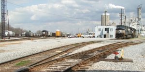

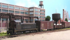

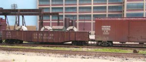

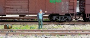

I say as far as what colors go where, just put em anywhere! Look at the photo's on the last few pages of this thread and you'll see what I mean:
http://www.the-gauge.com/forums/showthread.php?s=&threadid=8886&perpage=5&pagenumber=23
Look at the difference in color betweenthe two exposed tracks in the 4th pic down here:
http://www.the-gauge.com/forums/showthread.php?s=&threadid=8886&perpage=5&pagenumber=24
And if you haul grain, don't forget a little greenery here and there :D
