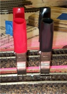

A couple of suggestions. Make sure to use a rosin core solder and not acid core. I like the liquid variety since it flows easily between the rail and coupler. I also use a couple of large electrical clips as heat sinks. Placed on either side of where I'm soldering, they help keep the ties from melting.
Doc
