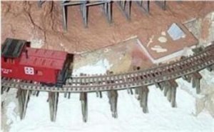

I just glued Atlas flex trak with plastic ties to a wooden trestle using Liquid Nails for Projects. I dabbed a very thin layer on the underside of the ties and then clamped it to the trestle top plate stringers overnight. Worked great.:thumb:
