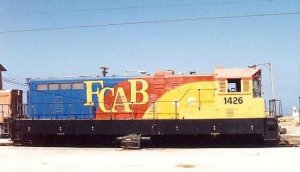

I'm going to attempt my first kitbash. I want to build an ex Canadian National narrow gauge EMD NF210. What are the basic tools that i need for a successful project?
