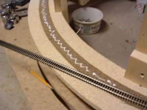

Sometimes a photo helps. I am building a helix so here is a photos showing how I spread glue on the cork roadbed with the next section of flexttrack ready to be put in place. I have already joined it with soldered connectors.

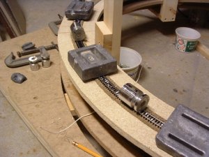

This photo shows the track in place held there by weights. I use some old scuba weights and a couple of scale weights I have.

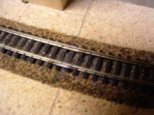

Xavier, I do not remove any ties. I make a fine saw cut under the rail which removes the plastic spikes from the plastic base that are meant to hold the track in gauge. I just cut back far enough to accomodate half a connector. With that done on both flex track sections I put the connectors on one and slide the track from the other section into the connectors. Look at this photo and you can see, the ties are where they shoild be.
