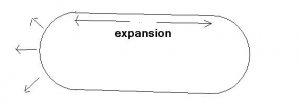

So taking that figure and putting it into a loop with a 60 feet circumference circle will mean the rail would increase in length .120 inch in 20 degrees. If the joints are gapped in spots the rail will slide in the ties and circumference will stay the same. But if all joints are soldered the circumference must become larger which will then increase the diameter of the oval aprox. .040 inch. This will push sideways .020 inch on each and every tie on the layout. Fred
A more "real world" case, 48in diameter circle and a 100deg F change, produces nearly the same result of .020in. BUT wouldn't the effect of temperature and humidity changes on the wood components in the benchwork, etc., still be a bigger problem?
Yeah, it is on my layout. But that's hard to measure and quantify and is subject to interpetation and disagreement. The track figures alone are reason enough to use expansion joints and can be quantified. As to 60 feet, that was just a nice round number. In fact, in an oval the side push in a sealed oval would be greater on the curved ends because the straights would push the track in a linear vector into the curved areas and cause more side pressure in those areas. That too is hard to quantify. Fred
