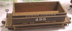

Does anyone have any resources for either scratch building or bashing ore cars?
I can't seem to find any plans anywhere on the net so I'm a bit reluctant to start from scratch. I was thinking about bashing either some HO gauge wagons or O gauge wagons, but I can't decide which way to go.
Has anyone got any ideas?
I'm after something like this as an end result.
Or this

The Yukon Copper looks great, I don't think it would be too hard to bash that one.
Please keep us updated. I love this On30 stuff and have a few running around in circles. Hope to get to some bashing myself one of these days.
