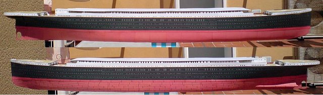

Now the problem is to paint the hull plating and disguising the court of original pieces to which I have made.
First the paint with a marker
But the result is not good and advised me try other solutions. For the next test short strips of colored hull and marks sheet and then the one to one hit to the hull. This time the result if I like.
Here you can see better comparison

The first attempt to simulate the hull plating was painting with a ruler and a marker
The result is not good, the grating are not parallel and have different widths
For the second attempt I do is cut strips of paper with the marks painted on and I hitting the hull, in these two photographs can be seen strips pasted on the helmet painted with felt pens.
Here you can compare the first hull against the final outcome, (it hurts so bad picture)
