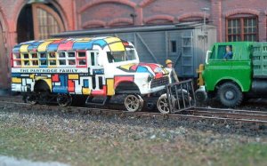

shaygetz
You just know the rivet counters are gonna be dying, especially when they see the headlights....

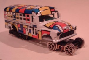

shaygetz
Billy Joe Ray Bob was caught sneeking it out of the shop shortly after the finishing touches were added....

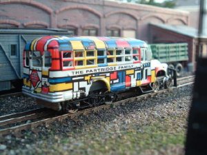

shaygetz
after all, couldn't you imagine the razzing the shoprats would give him seeing this on the bumper....

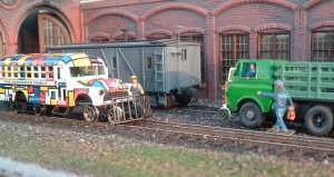

shaygetz
Shortly after that, Harley Rabidmouth, the shop steward was seen assigning "volunteers" to take it out on the main for a little breaking in.

shaygetz
A closer view of the final touchups, including "cowcatcher" pilot, doorstep and paint. I'll be posting pics of it running under full lights at the club layout shortly.

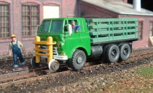

shaygetz
Thanks guys. Gary, the ground cover is parking lot dirt demagnetized and mixed with various manufactured ground covers sifted over it thru old grated cheese canisters.
The truck is my first serious kitbash from about 11 years ago. While it follows no particular prototype, it captures the look of a hi-railer parked near my house at the time.

shaygetz
The cab is Tyco, the frame, front wheels and (chrome plated no less:eek: )stake body came from a birthday party favor, the rear wheels and fuel tanks are Athearn. Hi-railer wheels came from N scale junk in my box. After I weathered the wheels, I lightly drybrushed silver over everything to highlight the details...just a fun project that got me started back in the hobby after a 2 year hiatus.

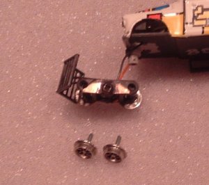

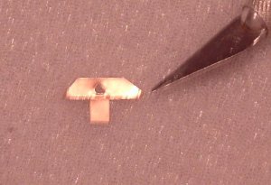

shaygetz
Ho Modeler said:
Shay
Can I ask how you built you electrical pickups on the trucks for your bus????
I am in dier neeeeedd to repair an old engine missing itst electrical pickups in its tender.
Maybe a walk through and pictures?
Eric
No problem, I use the bronze contacters supplied with Rix Rax switch machines as a starting point, bending them like so...

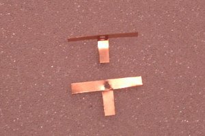

shaygetz
Then I cut contacts that just reach the inside of the wheels, making sure to crimp the ends slightly so that only they make contact with the wheel. I then polish them with a very fine emery cloth to reduce burrs. I cut the soldering point as short as necessary, shown here flattened for clarity.
