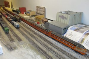

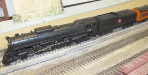

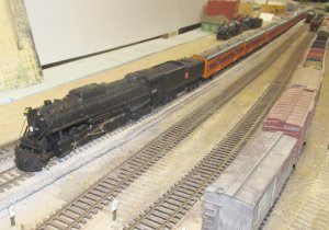

    I got some photo's of the Hiawatha. the locomotive's operation was disappointing, but the dcc system was strange, with either a low battery, or an intermittent short somewhere in the control loop. no locomotives worked well. and the throttles often got blinky and lost control.
    The big monster did drop the trailing truck, so it looks like it will need some kind of spring in there.

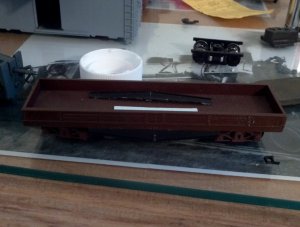

    Well here's the car. I'm thinking this might be a track cleaning car so I've taken the underframe components from a Accurail reefer underframe and chopped out most of the center section of the fishbelly. I then glued it back together and then onto the car. The blue thing in the car are the car numbers from Mr. Cedarleaf, I'll have to stitch them with another number because on my current roster of I don't have a number printed for it. It's number will be X53.
    I painted two boxcars with the rattle can today. After they completely dry I'll see how the color is, one car I primed and the other I didn't (it was a silver Accurail boxcar lettered for MoW).

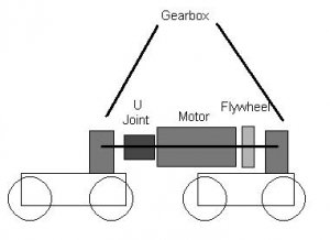

    While thrashing the diesels apart today as mentioned over in the Hustler thread I had a light bulb turn on upstairs. From another one of the club members I had recieved one of Bachmann's newer FT units' complete underframe. While briefly studying that I noticed that the driveshaft and worm seems to be reversible. I should have taken a picture but I was being hounded by my wife to get ready for dinner, so instead I whipped up a drawing on paint of how it might possibly work in the 4-4-4-0 project. Not sure about the flywheel but we'll see, either I can shave one of the F7's down or scrounge one up from something somewhere.
    Also since ripping apart the diesels, I found a use for their flywheels: http://www.freewebs.com/shaygetz/impactcar.htm

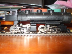

    Last night I got wild with it and busted out my Super American project to see if Bob's old Bachmann FT mechanism would be something I can use to power this beast. Short answer is no. Long answer is that the FT's axles are about 1/4" too far apart from the Rivarossi ones. Now here's my decision point; give NWSL oodles of my money and make a great running steamer or attempt new side rod fabrication?
