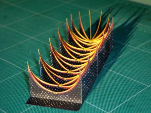

The first step is to build the complex ceiling

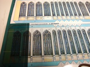

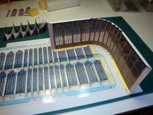

Then, prior to build the walls, I should decide how to make the windows. I started scanning the wall parts (inner and outer) and printing them on trasparent sheets.
Here you can see (above) the original outer wall and (under) the transparent copy.

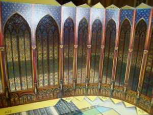

Then I removed all the windows from the paper walls and pasted the transparent copies from behind
The resolution of printing is nothing special but the general effect is pretty fine.

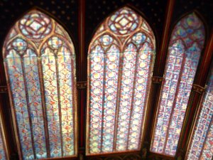

After closing the walls I realized that the windows, completely cut off, has a poor appearance in the external side.
Luckily I never waste anything so the cut windows was recovered to obtain some more details to add to external side.
Now they are slightly better from outside...
...and the inside view has improved as well.
