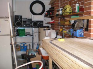

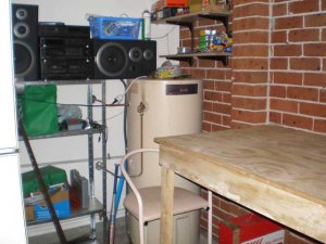

below is a few shots of some of the benchwork that i have started on already you may notice in the background of some shots that there is a hot water eater in the far corner, this sits appoximately 10 inches above the level of the benchwork ive already built i intend on havin a long run up the back wall to climb to this level and have a loop and return, i have a few ideas as to what id like to do with this wall run but really have no idea how to plan a Yard for the other side of the layout .

in the first phot the right hand side shows the garage door, i willbe building benchwork that will come across that door and extend 9 feet out from the wall, it will also stretch approximately 6 ft from the garage door back towards where the photo is taken from

In the first pic, you have 2 x 4 cross members on top of the bench work. I'm not sure of your plywood thickness, but plywood tends to sag if it isn't supported every 12-24 inches depending on thickness. I would get some more 1 x 4 or 1 x 3 lumber and make cross members between the front and back stringers mounted flush with the top of the stringers. Then remove the 2 x 4 cross members on top of the framework completely. Also put in a 1 x 4 across each end.

Russ, your dead right about the benchwork , the only reason i have left it so unsuppported is that im still not sure whether to gowith a flat top ply base or an open gid with risers style so i did not want to commit to either at them moment. the ply i have at the moment is 3/4 inch, i think ill go for a combination of both benchwork methods.

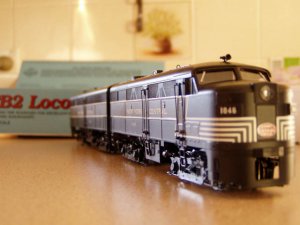

thanks steve, ill appreciate all the support i can get , as you know its daunting in the beggining!, specially when you know very little about modelling, but im not going to let that stop me, i just cant wait to get my NYC diesel going, i haven't got many loco's yet i just want to concentrate on the layout first and then put trains together that i think will look good on it. heres a pic of my first loco for the layout :)

and I have the water heater up one end and told myself i wanted a run the full length of the wall so this means i need to climb the track along the wall in order to clear the water heater.

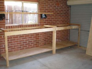

i didn't get alot done today it was just too damn hot, but i did extend the benchwork along the wall another 5 and a half feet ,
next weekend im going to build the benchwork over and around the water heater which will involve creating the platform for the 24" radius turn around above the heater.not sure exactly how ill do that yet in a way that will make it easy to disassemble if the heater ever blows, i guess ill have to make it semi removable i was half thinking of hiding the turn behind a mountain face so i dont have to scenic the removable section. still thinking.
