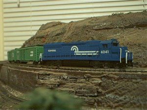

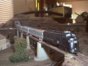

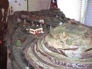

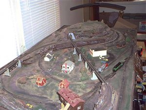

These are photos of the layout my son and I built about 7 years ago. It's a little rough and in need of some work. Once I figure out how to deal with the sagging problem, we plan to do track work and redo the scenery.
Moving it to Arizona took it's toll on it.

Yeah Ray, a few hours of effort will certainly be worth it. Maybe a renewed interest in N scale, eh????? How big is that?
Glad to see the Dewey Express was able to make it up Yarnell Hill..:D :D The "express" part is usually on the way down.:rolleyes: :rolleyes:

Thank you Tyson, And yes, Don, I think I got bit by that N-scale bug While I was visiting the CSRR. Thats ok though, Jumping between scales keeps model railroading fresh for me. (and keeps me busy)
Isn't that area around Yarnell a heck of a place to build a railroad. And that was the easiest route!
This layout is 2 1/2' x 5' . It's the only one we brought with us to Az. I sold one HO layout and dismantalled an Ho and 027 layout.

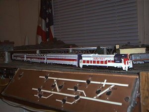

An Auto-Train?...man, you ARE old aren't you?:eek: :p :D Break out the scenic stuff, that layout's a keeper. Took me back to my N-scale daze with those pics.

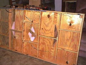

this old N scale layout is mostly wood and when we moved from a damp climate to a dry climate it dried out and bowed so bad the track was buckling. I was thinking of turning it on it's side and wetting it down then clamping it to a srtonger benchwork untill it dries, then spraying the bottom with expandable foam to give it added support.
Not sure when I'll get to that , seems I've got a lot of irons in the fire right now.
That Auto train is a real blast from the past , isn't it Shaygetz.

From this photo you can see why I urge people to start with a good sturdy benchwork. This was built with left over 3/8" plywood from a doghouse project. There just isn't enough support lengthwise, I didn't notice the problem before because it was supported by the table it was sitting on.

I wonder if a pair of the old L-girder rails from the Linn Westcott days of modeling would straighten it out...maybe 1x6 capped with 1x4 about 6" in lengthwise?
