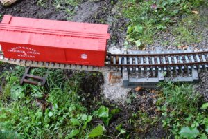

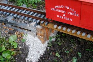

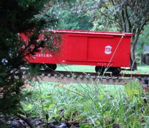

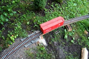

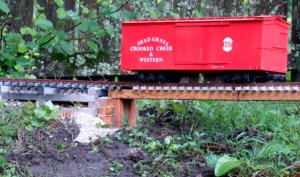

Timber abutment in place at Nelson's Gap
Well, the sawmill over at Townsend Tennessee rough cut some more heavy timbers and the logging and road crews hoisted them in place to construct a timber abutment at the very beginning of the trestle to span Nelson's Gap.
Before heading downgrade to a local watering hole the boys inched old #167 a box car from the neighboring Dead Grass Crooked Creek and Western out on to the beginning span to see if it all would hold together. Photo documentation was made to show the engineers and draftsman back at the home office that this project has merit.
The abutment was made using cut .7" X .7" garden stakes glued with Titebond III and pinned together. It rests on about 2" of crushed stone to promote drainage and limit wood rot. The wood was sprayed with Thompson's water seal. The stringers are resting on top of the abutment without anchoring to allow for natural contraction and exspansion of the wood and the brass rails.
Hope you like the pics.
Doc Tom:mrgreen:

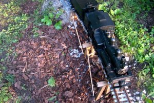

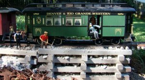

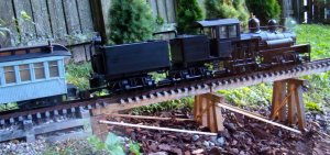

Doctor G

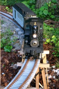

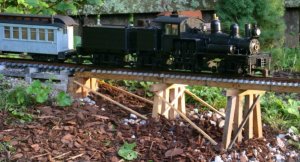

The Trestle at Nelson's Gap
Here are a few shots of the first part of the trestle at Nelson's Gap. This is my first attempt at trestle construction in large scale. I was quite pleased that the very heavy shay did not collapse this "collection of cornstalks and bean poles."
You can actually see why this design for trestle bents has been used for over a 100 years on RR's. They are very strong and sturdy.
I chose to space the bents about 20 feet apart which research said was done on real logging outfits to conserve wood on the very temporary trackage.
I also tried to represent the LRRR's approach to trestle building as well by putting up simple spindly side sway braces. You can see below a prototype picture from the LRRR. I have not dared try what the LRRR did and use entire tree trunks for the pole construction.
All and all I am pretty satisfied with this first foray into large scale trestle building.
Y'all let me know what you think.
Doc Tom :wave:

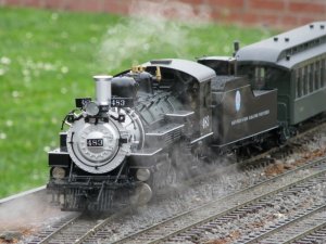

Boy, don't you know I have thought of "live steam" in the garden. Here is a pic of a live steamer on a garden RR. I have got to save up $$$ for 10 foot radius curved track to finish the LRRR before getting a live steam engine. But you know it is fun to dream.
see you soon. Dr Tom

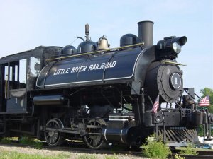

Good point Bill. I found a picture of restored LRRR #1. It is up in Indiana on a tourist line as well as LRRR #110. May need to make a trip up North to see these two under real steam.
I did "open up" another area in the yard that could go with smaller radii curves and the mill area at Townsend will have tighter curves as well.
Thanks for the input.
Dr Tom:wave:

Hey Bill,
Here is a photo of #1 not looking so good after it wrecked in to the Little River. It did clean up nice with that full restoration posted earlier.
While striving for authenticity I want to avoid these kinds of scenes along the Little River in the backyard.
I am not sure, but I believe the LRRR sold little number one soon after this wreck. It would be interesting to learn more about the wreck. May have to swing by Townsend and pay a long visit at the museum
doc Tom:twisted:

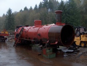

Bill,
Looks like LRRR #7 "Skookum" the 2-4-4-2 you like is under going restoration out in Oregon. Here is the website http://www.ocsr.net/skookum/skookum.html Skookum is 100 years old!!!!
Here is a picture of the boiler restoration taken in 2007.
This would make for four surviving locomotives counting #2147 sitting out front of the Townsend Museum.
Doc Tom:mrgreen:

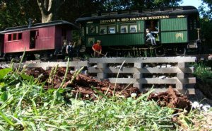

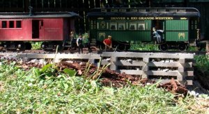

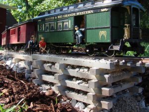

Colorado Mountain MEN help build some cribbing
Hey Guys,
Some Colorado Mountain Men were hired to help build some cribbing on the Little River. Seems they decided to come with their own varnish to keep comfortable in the wilds of Tennessee. It also seems like their are a lot of "bosses" and only on one worker. No wonder it is taking so long to get this cribbing done.
Doc Tom:cool:
