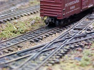

Here's a shot of the Peco track on my industrial branchline...
The 30 degree crossing is code 80, while all the other track is code 55...there is no problem mating the two types of track.
I didn't ballast this track as much as just kind of extend the scenery over it...mostly dirt & cinders. I was trying to get a kind of trashy, industrial type of look.
Charlie,
You certainly succeeded. :) I think I'm heading for code 55 track as soon as I get my feet wet a bit more and feel more comfortable with what I'm doing now. I'm assuming it's going to be tougher working with code 55 as far as level and alignment.
