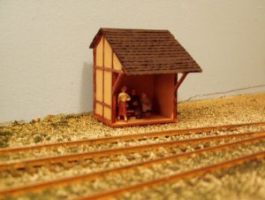

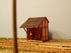

Chris: I think your roof turned out a touch better than mine. Isn't it a bore cutting all those notches? I tried doing multiple layers and it all slid around under the ruler.
(Notes: shingles seem to be a foot square. I made mine in 4mm strips with notches at 4mm, then offset them about 2mm between strips.)

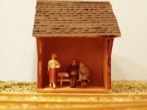

Did you think there was a bench in the shelter? I thought I had a piece, but I don't seem to have installed it.
interurban
Aug 21, 2002
4,407
76
Pickering. Ontario. Canada.
I cheated David, I guessed the shingle cut and held 4 or 5 in my hand and cut them that way.
I thing the black paint I added to hide some glue run off brought it together better.
Bench ?
You had installed one in yours David at the show.
I had a spare one already made up so I added it I am going to add a couple of adds inside and out side mine.

One note for anyone building the shelter, as Chris and I both had this problem.
The walls consist ofa sheet of scribed wood and a cutout of the framing. The back wall scribed sheet is just a little too narrow and daylight shows through in the corners. (Chris seems to have done something about it.) the framing sheet fits OK, so the wall needs a bit of extra on the sides.
