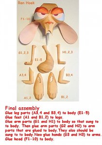

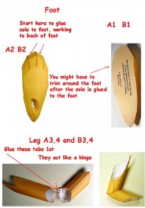

Bazookajo's Ren Hoek is a great build.
This how I built my Ren.
I used 67 lb cover stock paper,tried 110 lb card stock didn't like final product.
Take your time,look at the pictures and have fun.
Telman
