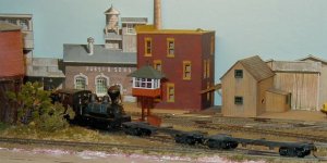

    Don't know how it happened but the switchman of this empty logger has shovelled his train into a towns' Industrial complex where timber is as scarce as hens teeth!
    He said he had one of his "senior moments" so I told him he can't play on the team no more! (Don't let on I have such moments myself :eek: ) I'll probably re-hire him next week seeing as he has a sense of humour!

    Shamus, On a more serious note...... The 2 truck MDC Shay in the foto runs rather jerkily. I've heard that having the side and con rods driven from just one truck gear avoids the need for absolute gear alignment/synchronisation. Have you any experience of this?
    Answers from anyone else on the forum would also be most most welcome because I have an HOn3 kit waiting for me to assemble the siderods/gears and they look too fragile to mess around with too much.
    By the way, the motor/main gearbox/ trucks are all free moving, that's why I think the problem lies in the siderod gears.
    Errol

    Hi Errol, Having the rods driven from just one gear works! I have done that with my HOn3 MDC shay. MDC even says in their instructions that the "timing" is critical and that the rods can be driven with just one gear. Mine runs like a watch now.

    Yes, all my MDC shay run great with just the one gear turning the cranks, just make sure that all the moving parts are good free running parts, and all will work fine.
