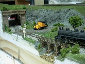

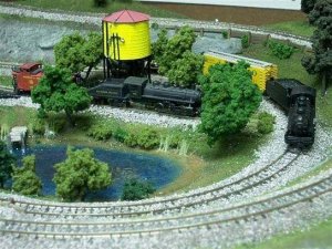

I have a half dozzen of these loco's plus we have one running on our display at the hobbyshop I work at. It was actually a return from a customer that said the loco didn't run to his satisfaction. That was 3 months ago and the loco has run 10 hours a day every day since then. It has out lasted every diesel that we have tried on the layout. I have a few of the previous versions with a little wieght and the above mods that will pull close to 20 cars.
A few shots of the mine on the display layout before we finished it.
