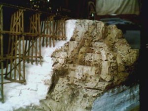

I Thought I would try eliminating carving the rock in plaster and just do it with the styofoam instead. I like it much better. just wondering how many of ya'll do it this way?
Heres a couple of pic's taked while the colour is being built up. Except for the out croppings it'll be covered with ground foam and trees.
Sorry for the photo quality :rolleyes:

I'm jealous. I gave up on foam 'cause I could never get it to look right. I went back to good old plaster. How did you get such a smooth face (surface) without losing the striation detail? Every time I tried to smooth the face, I either got little "nubs" all over the place, or it looked like a ceramic tile (no fine surface detail).
You posted the pics, now you gotta' suffer having the rest of us pester you to tell us your secrets...:D

t. alexander
Jun 20, 2002
540
61
Attalla Al.
Hi guy's.
Once the blue foam is built up all the rock carving was done with one of those larger (wide) snap off type razer knife blades. Sticking it in the foam and prying out snaps the foam and makes really nice strata type formations. I'd then slice the foam using the blade the way it's supposed to be used for smooth face's. slicing thin pieces and pulling out makes even the smooth face rock have a nice texture. I found that smaller boulders look great to made with the foam
Painting
Once carved I painted the section with flat off white latex Just to give me a "clean canvas" Then starting with the darkest color which in my case was a blackish brown I painted over the white with that making sure to get into all the cracks & crannies. The technique is called "back shadowing" I believe. Then it's just a matter of layering on lighter colours to suit ya'. A blow dryer really speeds up the paint drying time.
Anyway I think I've mixed my last batch of plaster for rock work. This seem's to work better, for me that is.

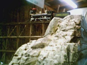

Heres another pic. Still have to put the final colour on.

Drew1125
Jan 28, 2001
2,975
Hmmm...
I might have to try that one, t.
It looks really good!:cool:
And just think how lightweight a layout built that way would be!

Yes Charlie, the wieght is another big plus.
Tonight I finished up the rock work. I dusted on pastel chalks for the final colouration and toned down the "backshadowing" a bit. I am pleased with the result and no more plaster mess.
I should also say that the painting Is a combination of actual painting, washes and dry brushing.

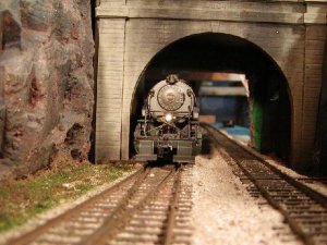

Here's a photo of one of Pete's locos, I'm posting it here because the rock work to the left of it is that blue foam. This was pretty much just a piece of scrap, I thought it looked like rock, and it turned out it did!

Hey Gary, Thats one great picture, you should try and black out the inside of the tunnel and it would be perfect!! I experimented with the foam also, I don't think I will ever go back to plaster again!!:eek:
