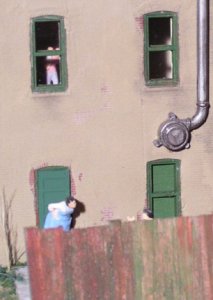

I used spackle on the back of a building to get a stucco effect, then painted it with Polyscale "aged concrete". A bit of carelessness applying the spackle gives the look of the stucco wearing off here and there.
Val
