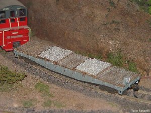

Another source of "old wood" for those of us too cheap to buy it "ready made...";)
When I started modeling, my weekly budget was extremely limited so I always looked for ways to do things "on the cheap." I would see a lot of old furniture thrown away while I was out wandering around in the desert. I began to notice (as I'm sure many others have) that weathered and peeling wood veneer looks a lot like miniature weathered wood when cut up. As there was a surplus of tossed furniture around I began to collect pieces. These pieces range anywhere from paper thin (the cheap furniture) to 1/16" thick (the good stuff). The thin stuff makes a great way to detail an existing structure that does not need support. It can also be cut with a pair of scissors. The thick stuff can be used for making buildings, just like the stuff you buy. Now, I admit, there is more work involved in "reclaiming" veneer, but for those of us on a limited budget, it is an alternative.
Here is a pic of a MOW flat I am working on showing a layer of thin veneer applied to the top. Although it doesn't look as good in the low detailed picture, it is quite good looking in reality.
Tom F
