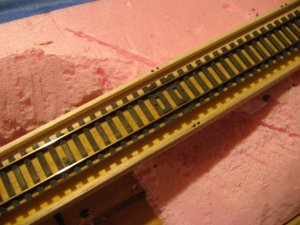

In other news, I carved some more rocks on the mountain and painted them. The earth color was adjusted a little as well because before it was just too red for my taste. Its also impossible to see, but I painted the rails of the track (and made sure it worked, I just had to see some trains going into the tunnel tooth1)
I think I am going to take a quick break from rockwork, though, because I still have to cut some fascia boards out of plywood. I want to get all the outlines and "shape" of the layout before I proceed further and realize that I am unsure about it. I would hate to rip up scenery before its done :rolleyes:. If I am lucky, I can get that done tomorrow as well to get back to some of the fun stuff.:mrgreen:

VERY NICE! what grade is your incline. i'm getting ready to start a layout and i like the way you did the mountain. how about access to the inside of the mountain?
Ginns
As far as access to the mountain, I cut a 9 inch by 10 inch hole in the side of the fascia. I plan on attaching hinges to it so I can open and close it when needed.
I decided to make an *official* grade measurement and it ended up being 3.3%. I had originally cut the blocks for 3%, but forgot to factor in the plywood, which ended up adding more. The trains on the 4x8 won't be pulling more than a few cars at a time, so this is good enough for me.

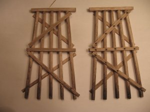

Work on the layout has been slow, but I did manage to finally start the bridge. I am planning on making a ballasted trestle for ease in construction, but am not sure how prototypical it would be. Hand laying track on a bridge is a little too ambitious for me at the moment, especially since a derailment could mean catastrophe for my little steam engine :eek: I may just go the extra mile once I build all the bents, but I'll see how it goes.
For now, here are some pictures of the two bents I built. They are the highest point of the trestle and are about 5" tall. Again, this trestle is not the most prototypical creation you will ever see. I have just been making them by sight and I think they turned out well enough. I got the plans for the bridge on google books.. I was surprised how much content they publish for free. I was able to get all the information I needed :) I may need to darken them more because the burnt umber wash turned out a little light. The bolt-like things are actually atlas track spikes. I have a whole bunch of them and no place to put 'em, so I cut off the tops, dabbed some glue on them, and pushed them into the balsa wood. I only did it on one side of one bent, so I am not sure if I will put them on all of them yet. They are pretty massive for scale size, if my math is right, but I will leave them on for now and see how I feel about them later :p

Ginns I think the atlas spikes make it look better than with out. The size looks pretty good, just my opinion

think your trestle bents look good. the spikes look good and to me the color looks about right
